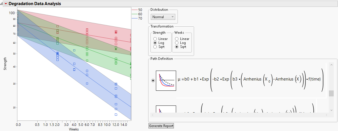

Given data exhibiting a negative slope over time, the fitted model can produce a plot similar to Figure 8.13. The figure is for Adhesive Bond.jmp. The selected temperature measurement scale is Celsius and the specified temperature under typical use conditions is 35 degrees.
Figure 8.13 Example of First-Order Kinetics Model Type 3
