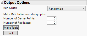

Specify details for the output data table in the Output Options panel. When you have finished, click Make Table to construct the data table for the design. Figure 9.17 shows the Output Options panel for a standard design selected from the Design List. For a main effects screening design, only Run Order is available.
Figure 9.17 Select the Output Options
The Run Order options determine the order of the runs in the design table. Choices include the following:
Rows in the design table are in random order within the blocks. (Not available if you select Construct a main effects screening design.)
Specifies how many additional runs to add as center points to the design. A center point is a run where every continuous factor is set at the center of the factor’s range. This option is not available if you select Construct a main effects screening design.
