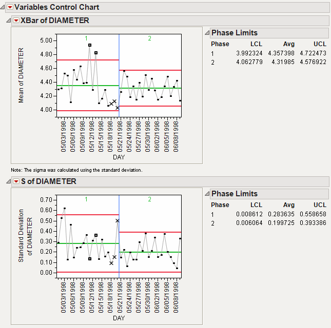

Open Diameter.jmp, found in the Quality Control sample data folder. This data set contains the diameters taken for each day, both with the first prototype (phase 1) and the second prototype (phase 2).
Select Analyze > Quality and Process > Control Chart > XBar.
5.
6.
7.
Click OK.
Figure 4.28 Phase Control Chart
