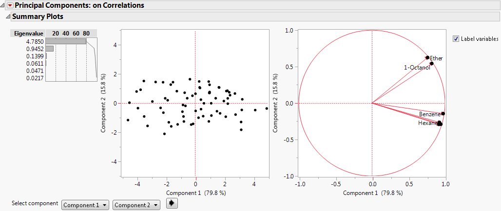

The initial Principal Components report is for an analysis on Correlations. It summarizes the variation of the specified Y variables with principal components. See Figure 4.4. You can switch to an analysis based on the covariance matrix or unscaled data by selecting the Principal Components option from the red triangle menu.
Figure 4.4 Principal Components on Correlations Report
