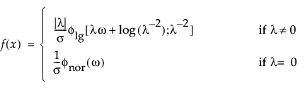

Returns the probability density function (pdf) evaluated at x of an extended generalized gamma probability distribution. The pdf is parameterized as follows:
is the pdf for the standardized log-gamma variable and κ > 0 is a shape parameter.
A number at which the pdf is evaluated. x must be greater than 0.
The scale parameter σ, which must be greater than 0.

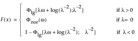

is the cdf for the standardized log-gamma variable and κ > 0 is a shape parameter.
A number at which the cdf is evaluated. x must be greater than 0.

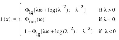

Returns the probability that a generalized logarithmically distribution random variable is less than x. The cdf is parameterized as follows:
A shape parameter λ, which must be greater than 0.

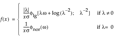

Returns the probability density function (pdf) evaluated at x of a log generalized gamma probability distribution with parameters mu, sigma, and lambda. The pdf is parameterized as follows:
is the pdf for the log-gamma variable and κ > 0 is a shape parameter.
