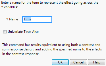

Time should be entered for YName. If you check the Univariate Tests Also check box, the report includes univariate tests, which are calculated as if the responses were stacked into a single column.
8.
Click OK.
Figure 9.9 Repeated Measures Window
