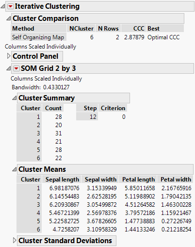

Figure 12.9 Self Organizing Map Report
The Cluster Comparison Report shows the total number of clusters and also the number of rows requested. The SOM report is named according to the Grid size requested. The Bandwidth is given at the top of the SOM Grid report. The report itself is analogous to the K Means NCluster report. See K Means NCluster=<k> Report.
