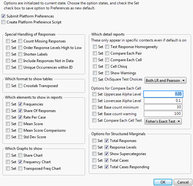

Figure 3.6 Set Preferences Window
Select the Set box for the options that you want to set. Select the option box if you want the option to appear by default, or deselect the option box if you do not want the option to appear by default. To submit the changes that you make to the platform preferences, select the Submit Platform Preferences box. To save the change that you make as a preference script, select the Create Platform Preference Script box. When the Categorical platform is launched, the preferences associated with the current preference set are used to create the Categorical report.
