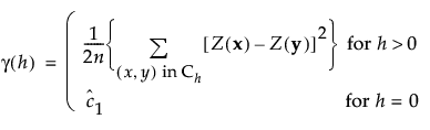

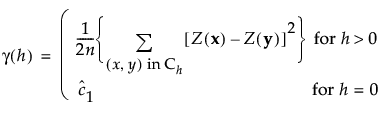

The semivariance function, γ, is defined as follows:

Empirical Semivariance
is an estimate of the nugget effect.
