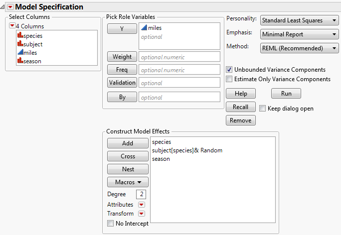

Select Help > Sample Data Library and open Animals.jmp.
Select Analyze > Fit Model.
Select miles and click Y.
Select species and subject and click Add.
7.
Click Nest.
This adds the subject within species (subject[species]) effect to the model.
8.
Select the nested effect subject[species].
9.
Select Attributes > Random Effect.
This nested effect is now identified as an error term for the species effect and appears as subject[species]&Random.
10.
When you define an effect as random using the Attributes menu, the Method options (REML and EMS) appear at the top right of the dialog. The REML option is selected as the default. The completed launch window is shown in Figure 4.19.
Figure 4.19 Fit Model Dialog
11.
Click Run.

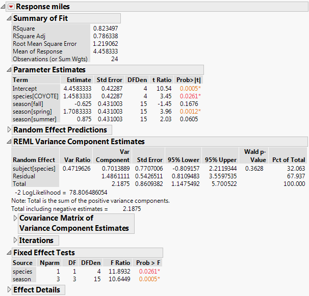

The report is shown in Figure 4.20. Both fixed effects, species and season, are significant. The REML Variance Component Estimates report gives estimates of the subject within species and residual variances.
