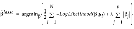

An l1 penalty is applied to the regression coefficients during Lasso. Coefficient estimates for the Lasso are given by the following:
is the l1 penalty, λ is the tuning parameter, N is the number of rows, and p is the number of variables

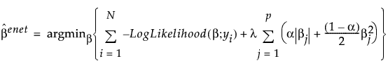

The Elastic Net combines both l1 and l2 penalties. Coefficient estimates for the Elastic Net are given by the following:
is the l1 penalty
is the l2 penalty
α is a parameter that determines the mix of the l1 and l2 penalties
