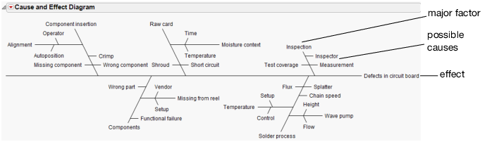

In Figure 13.5, the effect or problem, Defects in circuit board, appears on the right as the center line. The major contributing factors appear at the end of the branches (Inspection, Solder process, Raw Card, and so on.) Possible causes branch off each major factor.
Figure 13.5 Cause-and-Effect Diagram
