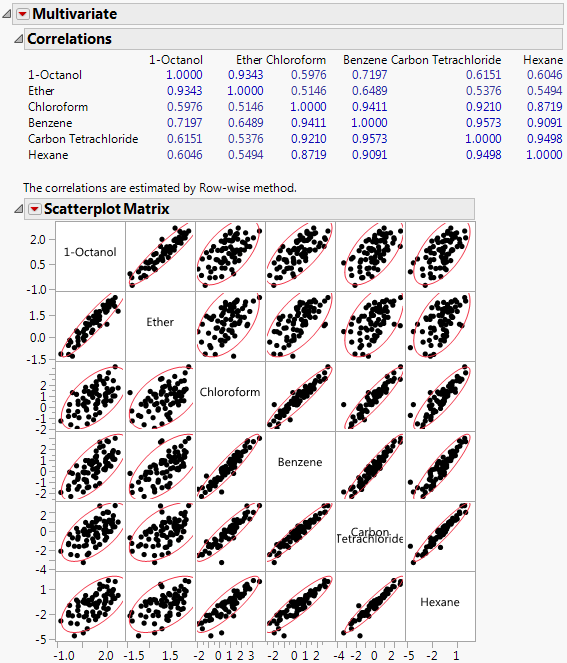

The default multivariate report shows the standard correlation matrix, the scatterplot matrix, and a note about which method was used to estimate the correlations. In some cases, information that explains why the given method was used is also displayed. The platform menu lists additional correlation options and other techniques for looking at multiple variables. See Multivariate Platform Options.
Figure 3.3 Example of a Multivariate Report
