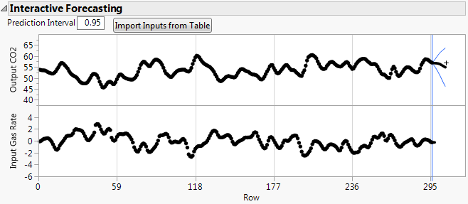

Figure 16.14 Interactive Forecasting Graph
