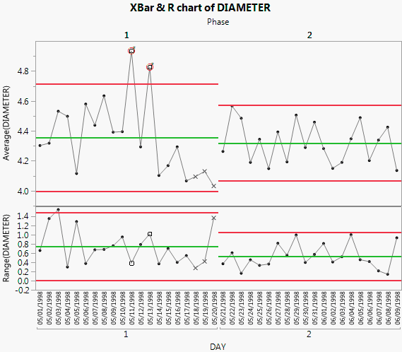

In the Average chart, right-click and select Warnings > Test Beyond Limits.
Figure 3.14 Control Charts for each Phase
Including the Phase variable means that the control limits for phase 2 are based only on the data for phase 2. None of the phase 2 observations are outside the control limits. Therefore, you can conclude that the process is in control after the adjustments were made.
