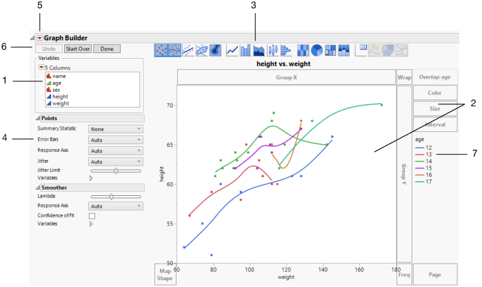

To launch Graph Builder, open your data table and then select Graph > Graph Builder. The Variables list contains the columns in your data table, which you can drag into zones.
Figure 2.2 Graph Builder Window for Big Class.jmp

To recreate and modify the graph in Figure 2.2, follow these steps:
5.
The graph in Figure 2.2 appears. The relationship between height and weight for each value of age is shown using color in a single graph.

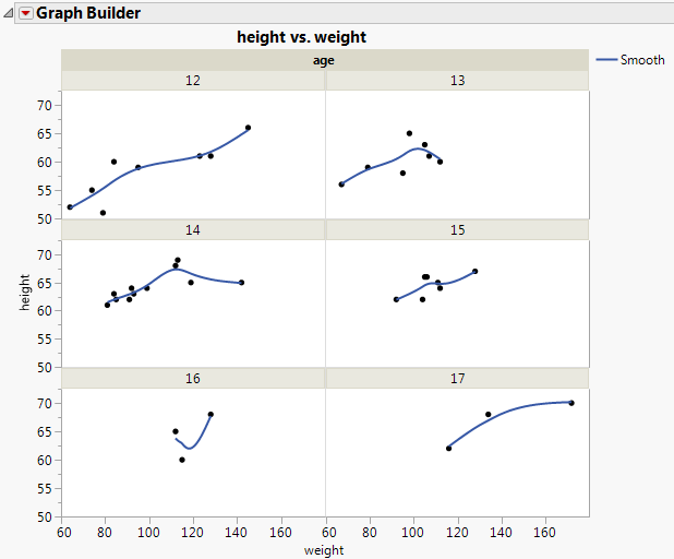

Figure 2.3 Height and Weight Grouped by Age
