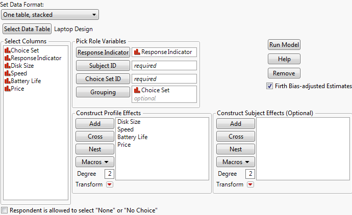

Select Help > Sample Data Library and open Design Experiment/Laptop Design.jmp.
2.
Run the Choice script.
Figure 17.6 Choice Model Launch Window
The only grouping variable is Choice Set because there is a single survey and a single respondent.
3.
Click Run Model.

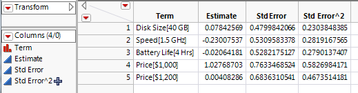

To construct the final choice design that you will give to ten respondents, you need prior means and variances for the parameter estimates. The analysis in Figure 17.7 gives estimates of the parameter means (Estimate) and estimates of their standard errors (Std Error). You will treat the standard errors as prior estimates of the standard deviations. Next, to calculate estimates of the variances of the attributes, construct a JMP table and square the standard errors.
5.
In the new data table, right-click in the Std Error column header and select New Formula Column > Transform > Square.
A column called Std Error^2 is added to the data table. Its values will serve as your estimates of the prior variance for the choice model parameters.
Figure 17.8 Untitled Data Table with Variance Estimates in Last Column
