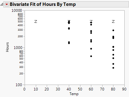

In the Devalt.jmp data, units are stressed by heating, in order to make them fail soon enough to obtain enough failures to fit the distribution.
Select Analyze > Fit Y by X.
5.
Click OK.
Figure 13.7 Bivariate Plot of Hours by Log Temp

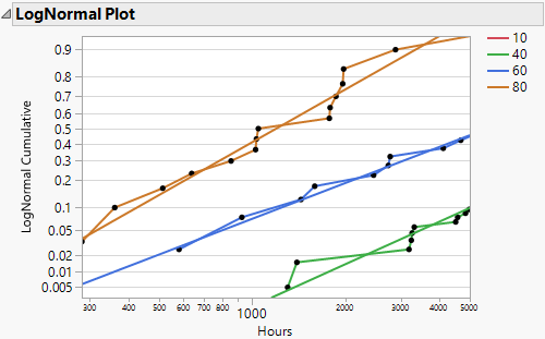

Select Analyze > Reliability and Survival > Survival.
7.
8.
9.
10.
11.
Click OK.
12.
13.
Click OK.
Figure 13.8 Lognormal Plot

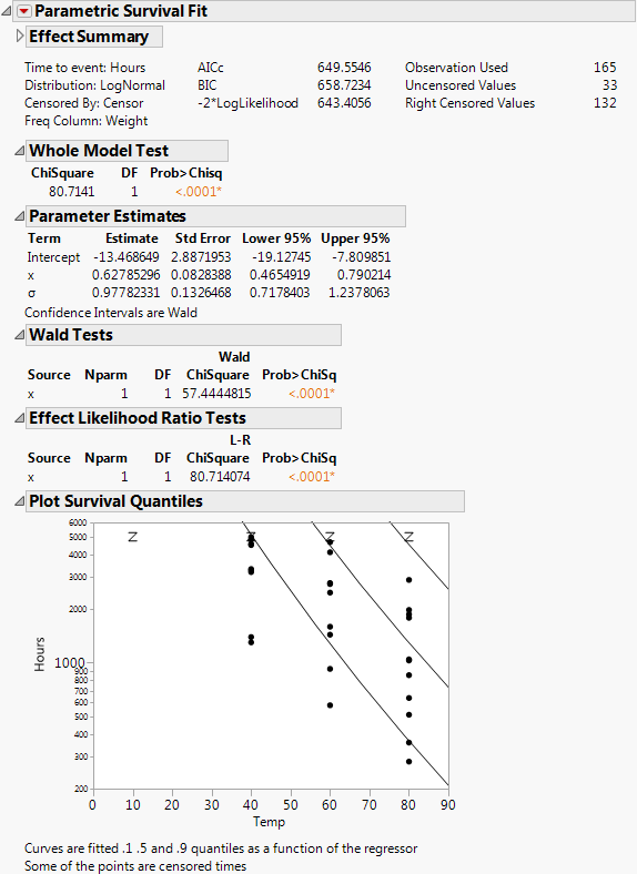

Select Analyze > Reliability and Survival > Fit Parametric Survival.
15.
16.
17.
18.
19.
20.
Click Run.
Figure 13.9 Devalt Parametric Output
If the effect column has a formula in terms of one other column, as in this case, the plot is done with respect to the inner column. In this case, the effect was the column x, but the plot is done with respect to Temp, of which x is a function.

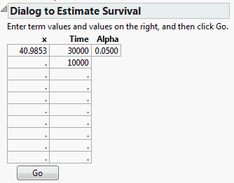

Enter the values shown in Figure 13.10 into the Dialog to Estimate Survival.
Figure 13.10 Estimating Survival Probabilities
23.
Click Go.
