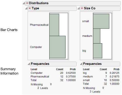

Figure 2.45 Example of a Bar Chart
This example uses the Companies.jmp data table, which contains data on the size and type of a group of companies.
Click OK.
The additional summary output gives detailed frequencies. This report is discussed in Distributions of Categorical Variables in Analyze Your Data.

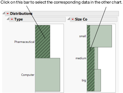

For example, suppose that you want to see the distribution of company size for the pharmaceutical companies. Click the Pharmaceutical bar in the Type bar chart, and the pharmaceutical companies are highlighted on the Size Co bar chart. Figure 2.47 shows that although most companies in this data table are small, most of the pharmaceutical companies are medium or big.
Figure 2.47 Clicking Bars
