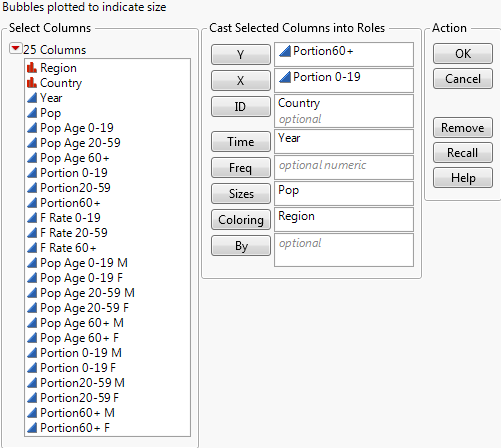

This corresponds to the Y variable on the bubble plot.
This corresponds to the X variable on the bubble plot.
5.
6.
7.
8.
Each level of the Coloring variable is assigned a unique color. So in this example, all the bubbles for countries located in the same region have the same color. The bubble colors that appear in Figure 2.76 are the JMP default colors.
Figure 2.75 Bubble Plot Launch Window
9.
Click OK.

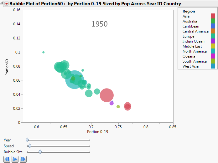

Figure 2.76 Initial Bubble Plot
Note: For detailed information about how the bubble plot aggregates information across multiple rows, see Bubble Plots in the Essential Graphing book.
Click the play/pause button to animate the bubble plot through the range of years. As time progresses, the Portion 0-19 decreases and the Portion60+ increases.

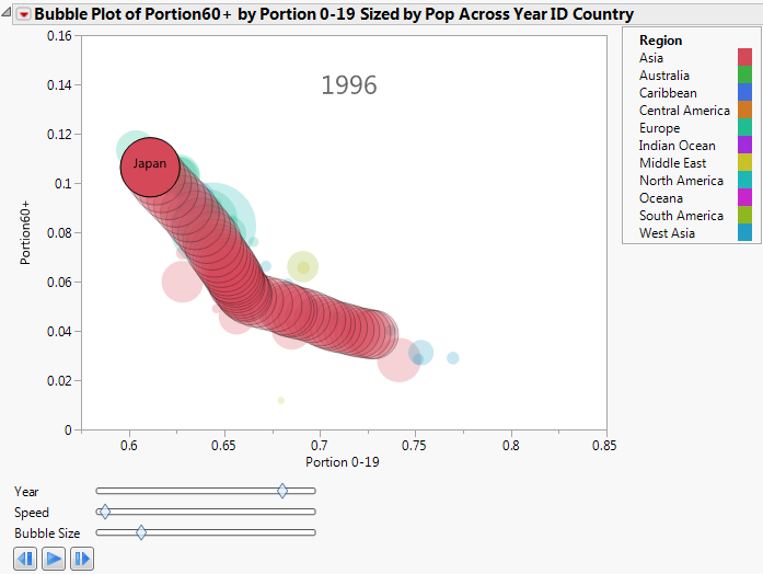

From the red triangle menu, select Trail Bubbles > Selected.
Figure 2.77 Japan’s History of Population Shifts
