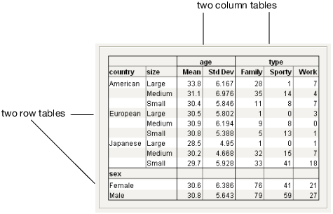

In Tabulate, a table is defined by its column headings and row labels. These sub-tables are referred to as row tables and column tables. See Figure 8.136.
Select Analyze > Tabulate.
Drag size into the Drop zone for rows.
5.
6.
7.
8.
Drag type to the far right of the table.
9.
Drag sex under the table.
Figure 8.136 Row and Column Tables
