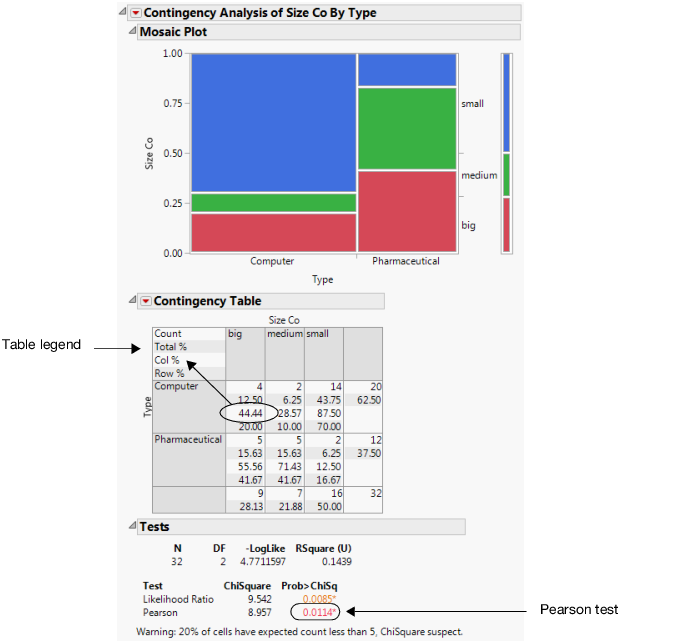

Figure 3.96 Company Size by Company Type

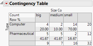

The Contingency Table contains information that is not applicable for this example. From the red triangle menu for Contingency Table deselect Total % and Col % to remove that information. Figure 3.97 shows the updated table.
Figure 3.97 Updated Contingency Table
To answer this question, use the p-value from the Pearson test in the Tests report. See Figure 3.96. Since the p-value of 0.011 is less than the significance level of 0.05, the financial analyst concludes the following:
