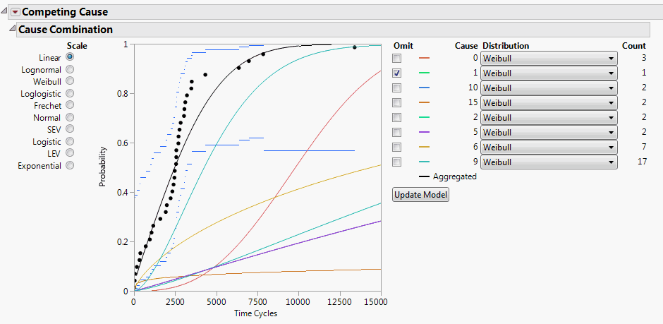

5.
Select Likelihood as the Confidence Interval Method.
6.
Select Allow failure mode to use fixed parameter models.
7.
Click OK.
Figure 2.23 Fixed Parameter Model with Cause 1 Omitted
9.

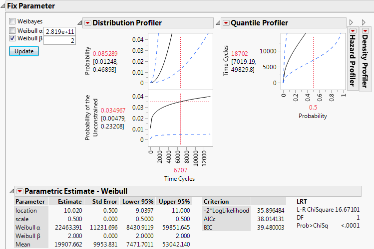

Select Fix Parameter from the red triangle next to Parametric Estimate - Weibull.
10.
Select Weibull beta and type 2.
11.
Click Update.
In the Parametric Estimate - Weibull report, assuming β equals 2, the alpha parameter is estimated to be 22463.391. Now you can use this for the failure distribution for Cause=1.

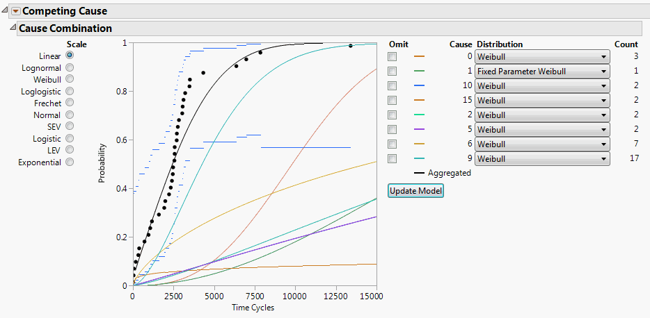

13.
Deselect Omit for Cause 1.
14.
For the distribution for Cause 1, select Fixed Parameter Weibull.
15.
Click Update Model.
Figure 2.25 Updated Model Showing Cause 1
