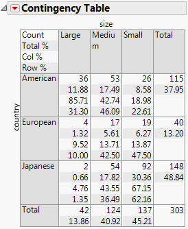

To produce the plot shown in Figure 6.101, follow the instructions in Example of Contingency Analysis.
Figure 6.101 Example of a Contingency Table
For example, in Figure 6.101, focus on the cars that are large and come from America. The following table explains the conclusions that you can make about these cars using the Contingency Table.
Percentage of all cars that are both large and come from America (36/303)1.
Percentage of large cars that come from America (36/42)2
Percentage of American cars that are large (36/115)3.
