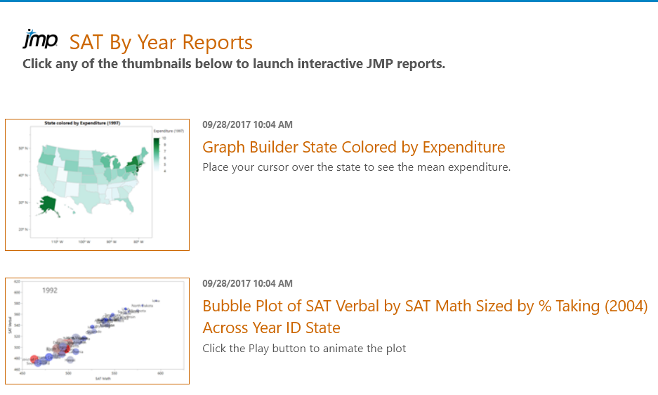

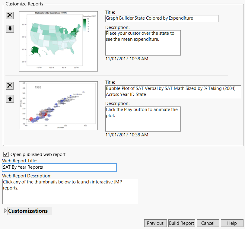

Note: If you selected one report, you have the option of generating an index page. The index page shows a thumbnail of the report. You click the thumbnail to view the report. Figure 9.4 shows an example.
Figure 9.3 Customizing the Web Report

Enter SAT By Year Reports in the Web Report Title box.
7.
Click Build Report.
Figure 9.4 Web Report
8.
Click on one of the thumbnails to open the report in an interactive web page. See http://www.jmp.com/support/help/InteractiveHTML/14/ShareJMPReports.shtml for details about working with interactive reports.
Enables you to specify a CSS file to format the web page. The CSS file is copied into a subdirectory called _css. The link to the CSS file is relative so that you can send the report and support files to another user and maintain the CSS formatting.
