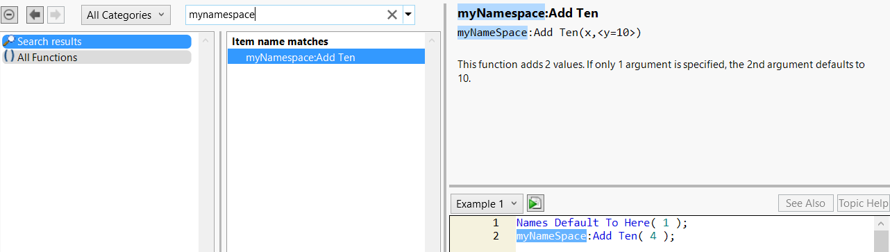

newAdd = New Custom Function( "myNamespace", "Add Ten", funcDef );
newAdd << Description( description );
newAdd << Prototype( "myNameSpace:Add Ten(x,<y=10>)" );
newAdd << Example( "myNameSpace:Add Ten(4)" );
// expr() Examples need to be passed inside NameExpr()
newAdd << Example( Name Expr( ex2 ) );
newAdd << Parameter( "Number", parmHint1 );
newAdd << Parameter( "Number", parmHint2 );

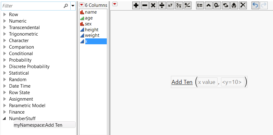

newAdd << Formula Category( "NumberStuff" );
// add myNamespace:Add Ten function to system
Add Custom Functions( newAdd );
Figure 8.8 Custom Function in the Scripting Index
The Formula Category message results in a new category in the Formula Editor’s list of formula categories. Custom functions are shown with an underline in the Formula Editor. Also see the hint text from the Parameter messages.
Figure 8.9 Custom Function in the Formula Editor
