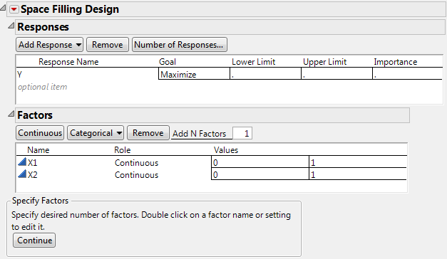

Select DOE > Special Purpose > Space Filling Design.
Alter the factor level values, if necessary. For example, Figure 20.6 shows the two existing factors, X1 and X2, with values that range from 0 to 1 (instead of the default –1 to 1).
Figure 20.6 Space-Filling Dialog for Two Factors
Click Continue.
5.

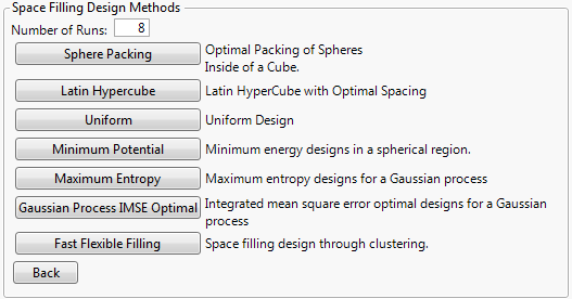

In the design specification dialog, specify a sample size (Number of Runs). Figure 20.7 shows a sample size of eight.
Figure 20.7 Space-Filling Design Dialog
6.
Click Sphere Packing.
JMP creates the design and displays the design runs and the design diagnostics. Figure 20.8 shows the Design Diagnostics panel with 0.518 as the Minimum Distance. Your results might differ slightly from the ones below, but the minimum distance is the same.
