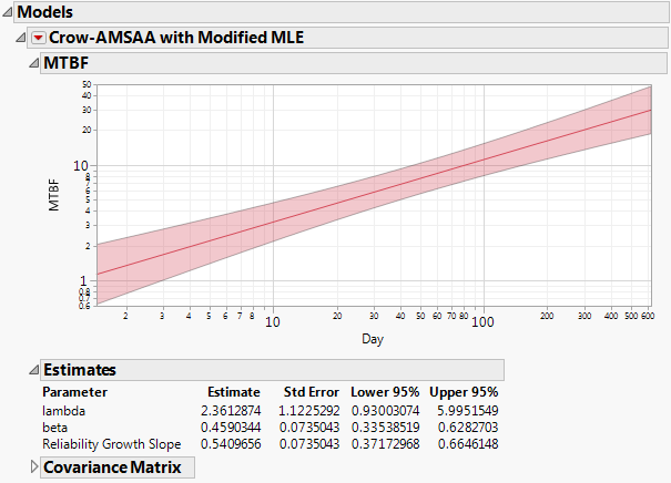

Figure 9.15 shows a Crow-AMSAA with Modified MLE fit to the data in TurbineEngineDesign1.jmp.
Figure 9.15 Crow AMSAA with Modified MLE Report
The formula for the bias-corrected estimate of β depends on whether the test is failure terminated or time terminated. See Parameter Estimates for Crow-AMSAA with Modified MLE for details.
When the Crow-AMSAA with Modified MLE option is selected, the Cumulative Events Plot updates to display this model. The Model List also updates. The Crow-AMSAA with Modified MLE report opens to show the MTBF plot, Estimates, and Covariance Matrix for the Crow-AMSAA with Modified MLE fit; this plot is described in the section MTBF Plot.
