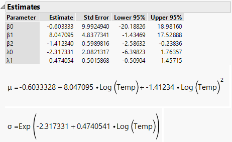

Figure 3.25 shows the location and scale transformations, which are subsequently created and included at the bottom of the Estimates report section.
Analysis proceeds similarly to the Example of the Fit Life by X Platform, where the Arrhenius Celsius Relationship was specified.
