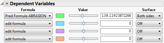

Most of the controls for Isosurface are identical to those of Sheet, points. Figure 4.10 shows the default controls, illustrating the slightly different presentation.
Figure 4.10 Dependent Variable Controls for Isosurfaces
