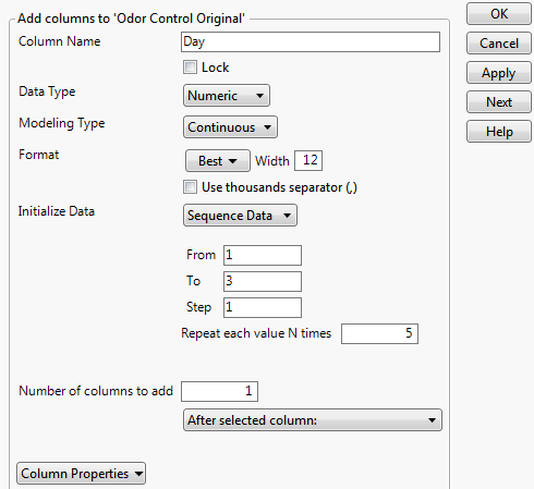

Select Cols > New Columns.
Next to Column Name, type Day.
5.
From the Initialize Data list, select Sequence Data.
1 for From
1 for Step
5 for Repeat each value N times
7.
Next to Number of columns to add, type 1.
Figure A.11 Completed New Columns Window
8.
The Day column is added as the second column in the data table.
