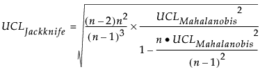

The UCL reference line (Penny 1996) drawn on the Jackknife Distances plot is calculated as
T2 Distance Measures
n = number of observations
p = number of variables (columns)
