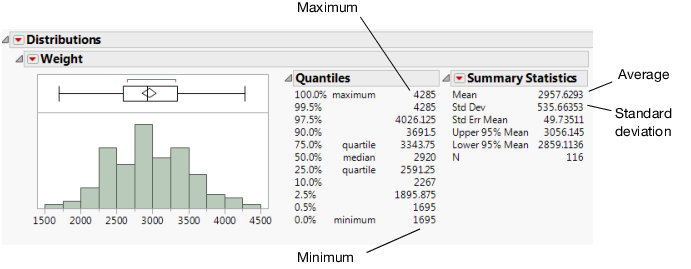

This example uses the Car Physical Data.jmp data table, which contains information about 116 different car models.
Click OK.
5.
To rotate the report window, select Display Options > Horizontal Layout from the red triangle menu next to Weight.
Using the results presented in Figure 3.84, the planning specialist can answer the questions.
The default report window in Figure 3.84 provides a minimal set of graphs and statistics. Additional graphs and statistics are available on the red triangle menu.
