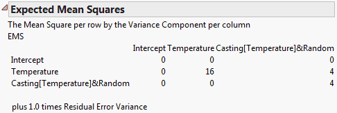

Figure 2.64 shows the Expected Mean Squares report for the Investment Castings.jmp sample data table. Run the Model - EMS script and then run the model.
Figure 2.64 Expected Mean Squares Report
