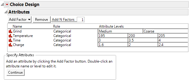

Select DOE > Consumer Studies > Choice Design.
Select Help > Sample Data Library and open Design Experiment/Coffee Choice Factors.jmp.
Figure 17.2 Choice Design Window with Attributes Defined
Click Continue.
