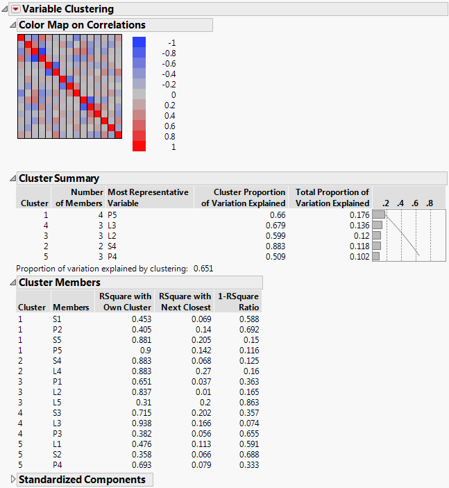

In this example, you use the Cluster Variables platform as a dimension-reduction tool for modeling. The Penta.jmp sample data table contains 15 variables used to predict the response variable, log RAI. Use Cluster Variables to reduce this number.
Select Analyze > Clustering > Cluster Variables.
Click OK.
5.
Click the Variable Clustering red triangle and select Save Cluster Components.
Figure 14.5 Cluster Variables Report for Penta.jmp
Click the red triangle next to Variable Clustering and select Launch Fit Model.
