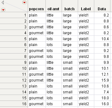

1.
Select Help > Sample Data Library and open Popcorn Trials.jmp.
2.
Select Tables > Stack.
3.
Select yield1 and yield2 and click Stack Columns.
4.
Figure 5.9 Stacked Data Table
The Label column represents the Source Label Column that identifies the source of the data. Its values are the column names in the original table from which the stacked values originated.
