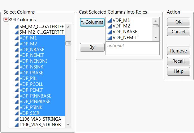

Select columns VDP_M1 through VDP_SICR and click Y, Columns. You should have 14 columns selected (see Figure 2.2).
Figure 2.2 Explore Outliers Launch Window

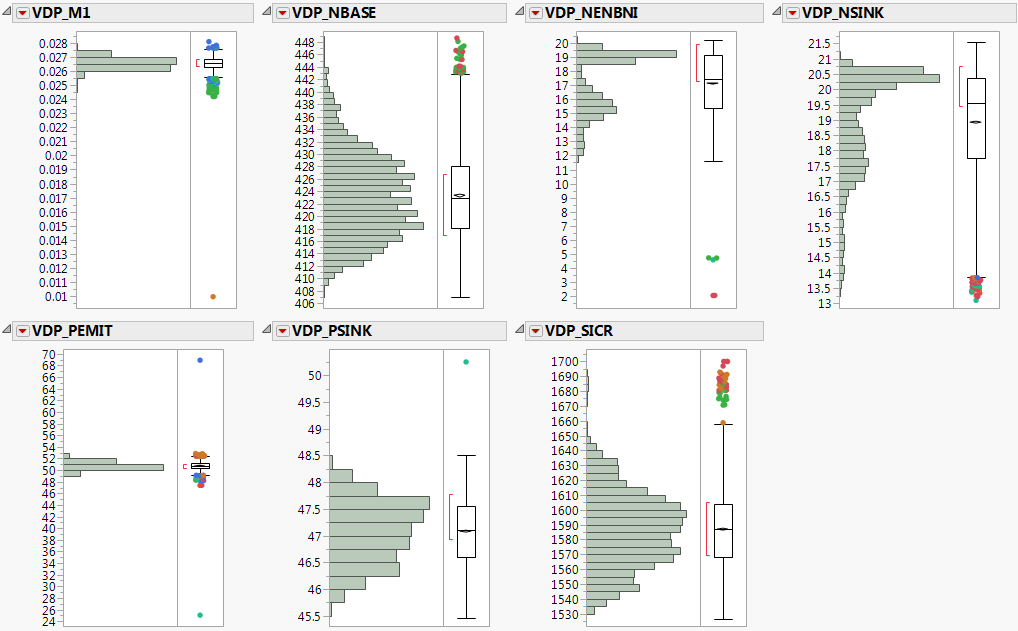

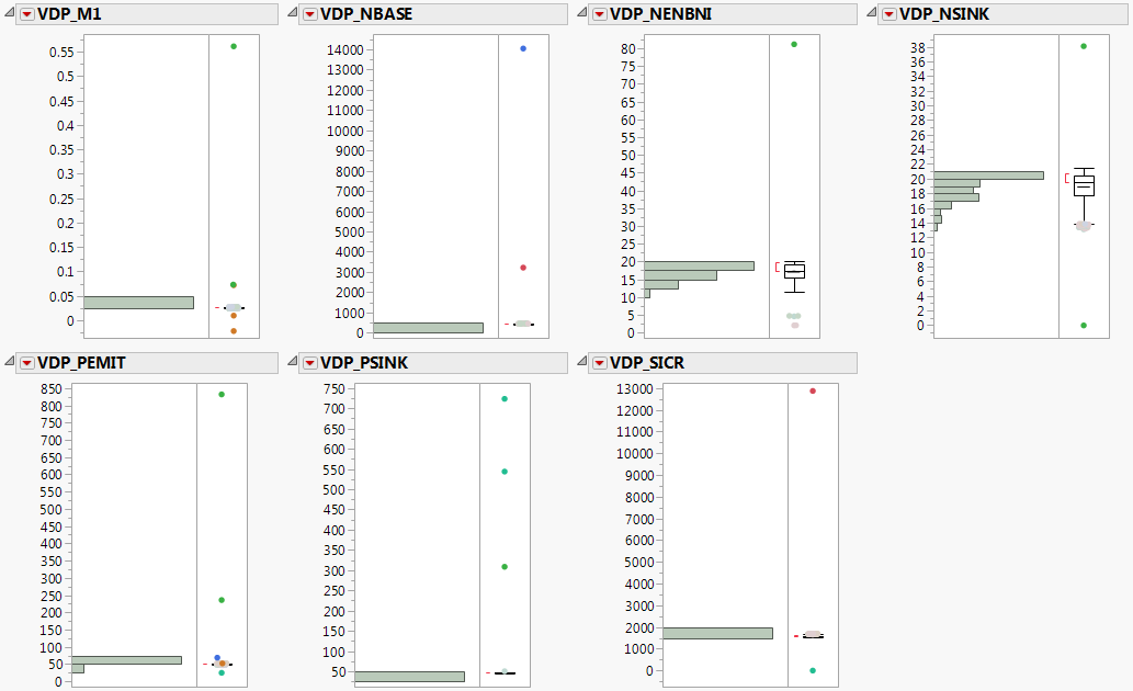

Figure 2.3 shows a simplified version of the report.
In columns VDP_M1 and VDP_PEMIT, notice that the selected outliers are somewhat close to the majority of data. For the rest of the columns, the selected outliers appear distant enough to exclude them from your analyses.
With the remaining columns selected in the report, click Exclude Rows.

Figure 2.4 shows a simplified version of the report.
