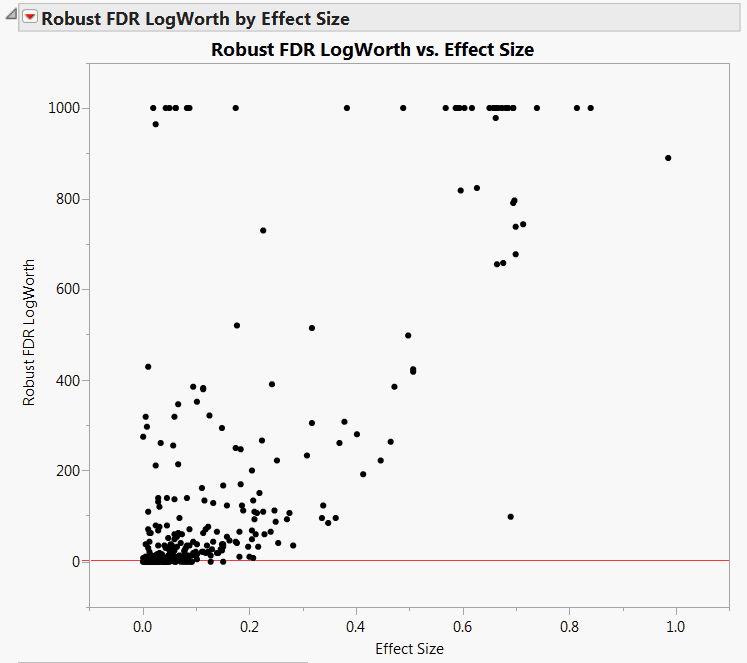

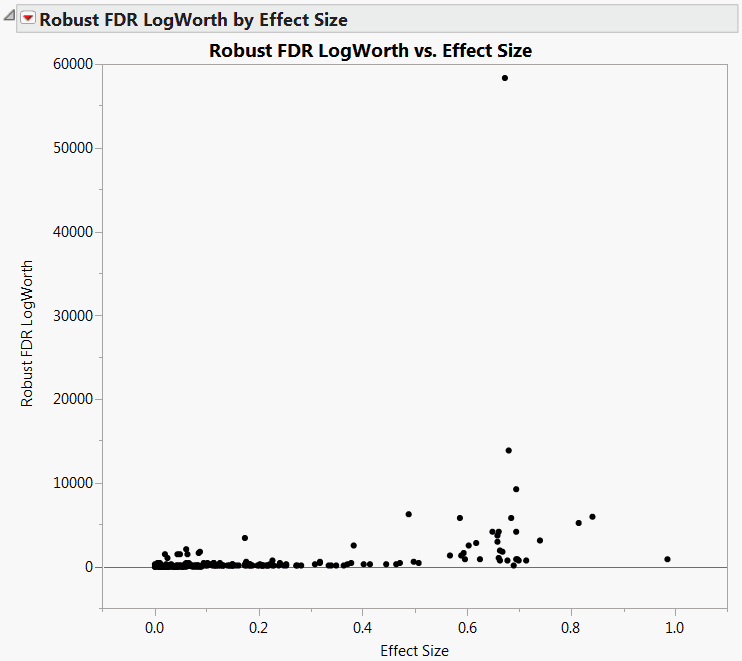

The detail in the plot is hard to see, because of the huge Robust FDR LogWorth value of about 58,000 (Figure 17.14). To ensure that your graphs show sufficient detail, you can set a maximum value of the LogWorth.
10.
Click OK.
