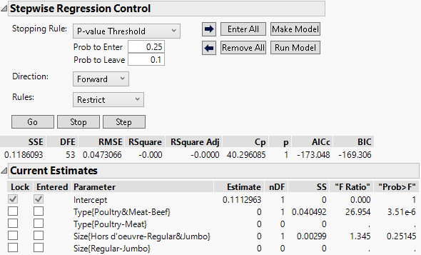

Notice that when you change from the default Rule of Combine to Restrict, the F Ratio and Prob > F values for two terms are shown as missing. These are the terms Type{Poultry-Meat} and Size{Regular-Jumbo}. This is because these two terms cannot enter the model until their precedent terms enter.

Click Step.
The term Type{Poultry&Meat-Beef} enters the model. This term has the smallest Prob>F value, and that value falls below the Prob to Enter threshold of 0.25.
Figure 4.19 Stepwise Control Panel with One Term Entered

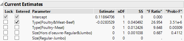

The the F Ratio and Prob > F values for the term Type{Poultry-Meat} appear. Since its precedent term has entered the model, Type{Poultry-Meat} is now allowed to enter.
10.
Click Step.
Since Type{Poultry-Meat} has the smallest Prob>F value among the remaining terms, and that value is below the Prob to Enter threshold, it is the next term to enter the model.

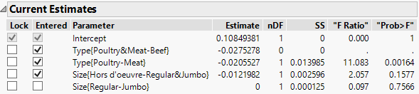

Click Step.
The term Size{Hors d'oeuvre-Regular&Jumbo} enters the model, since its Prob>F value is 0.1577. Because its precedent term is now in the model, the term Size{Regular-Jumbo} is allowed to enter the model and its Prob>F value appears.
However, the Prob>F value for the term Size{Regular-Jumbo} is 0.7566, which exceeds the Prob to Enter value of 0.25. For this reason, if you click Step again, it is not entered into the model.
Figure 4.20 Current Estimates Report for the Final Model
