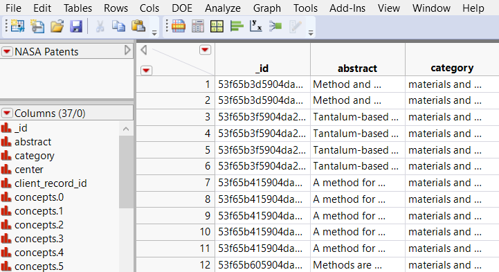

dt = JSON To Data Table( As JSON Expr( jsl_json["results"] ) );
// JSON to Data Table turns JSON data into a data table
// As JSON Expr turns a JSL associative array into a JSON string
dt << Set Name( "NASA Patents" );
Figure 13.5 Data Imported in a Data Table
