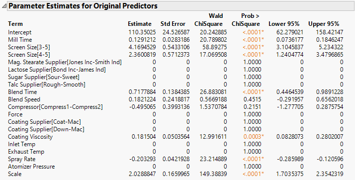

Select Analyze > Fit Model.
5.
From the Personality menu, select Generalized Regression.
6.
Click Run.
Figure 9.161 Model Based on Adaptive Lasso
You are interested in the parameter estimates shown in the Adaptive Lasso with AICc Validation report. Based on the non-zero parameter estimates, the model suggests that Mill Time, Screen Size, Blend Time, Blend Speed, Compressor, Coating Viscosity, and Spray Rate are related to Dissolution.

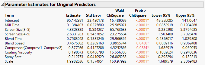

Click the red triangle next to Adaptive Lasso with AICc Validation and select Relaunch with Active Effects.
Click Run.
Figure 9.162 Reduced Model Using Adaptive Lasso
Notice that the estimate for Blend Speed has a confidence interval (Lower 95%) that comes very close to including zero. Next, perform a simulation study to see how often Blend Speed would be included in the model had other data values from the dissolution distribution been observed.

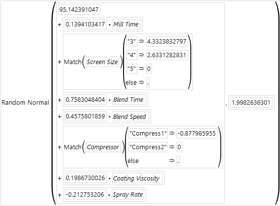

Click the red triangle next to Adaptive Lasso with AICc Validation and select Save Columns > Save Simulation Formula.
This adds a new column called Dissolution Simulation Formula to the Tablet Production.jmp data table.
(Optional) In the data table Columns panel, click the plus sign to the right of Dissolution Simulation Formula.
Figure 9.163 Simulation Formula
For each row, this formula simulates a value that could be obtained given the model and the distribution of Dissolution, which is estimated to be Normal with standard deviation about 1.998.

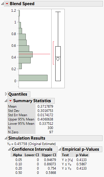

Press the Ctrl key, click the Intercept red triangle menu, and select Display Options > Customize Summary Statistics.
10.
Select N Zero.
11.
Click OK.
12.
Scroll to the Distribution report for Blend Speed.
The Summary Statistics report shows that for 97/300 = 32.3% of the simulations, the Blend Speed estimates are zero.
