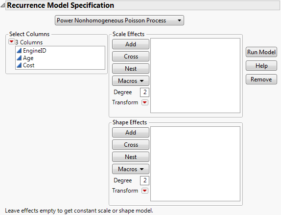

Select Fit Model from the platform red-triangle menu to produce the Recurrence Model Specification window shown in Figure 5.6.
Figure 5.6 Recurrence Model Specification
Table 5.1 defines each model parameter as a scale parameter or a shape parameter.
For the Recurrence Model Specification window (Figure 5.6), if you include Scale Effects or Shape Effects, the scale and shape parameters in Table 5.1 are modeled as functions of the effects. To fit the models with constant scale and shape parameters, do not include any Scale Effects or Shape Effects.

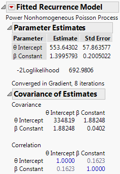

Figure 5.7 Model Report
