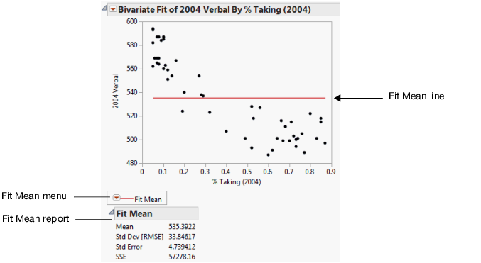

Figure 4.28 Example of the Fit Mean Option
Adds a horizontal line to the scatterplot that represents the mean of the Y response variable.See Fit Mean.
