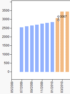

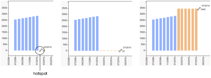

Figure 8.11 Add Production Periods
Figure 8.12 Adjust Production Counts
Tip: You can adjust future production counts by selecting Spreadsheet Configuration of Risk Sets from the Forecast report red triangle menu. See Spreadsheet Configuration of Risk Sets.
Right-click a blue bar and select Exclude to remove that risk set from the forecast results. You can then right-click and select Include to return that data to the risk set.
Tip: You can adjust existing production counts by selecting Spreadsheet Configuration of Risk Sets from the Forecast report red triangle menu. See Spreadsheet Configuration of Risk Sets.

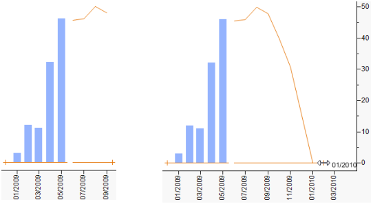

When you adjust production in the left graph, the right graph is updated to estimate future failures (Figure 8.13). Dragging a hotspot lets you change the forecast period. The orange line then shortens or lengthens to show the estimated failure counts.
Figure 8.13 Adjust the Forecast Period
