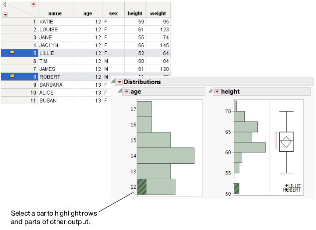

Double-click on a histogram bar, or right-click on a histogram bar and select Subset. A new data table that contains only the selected data is created.

Figure 2.6 Highlighting Bars and Rows
