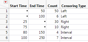

Figure 2.5 Censored Data Types for Two Response Variables
