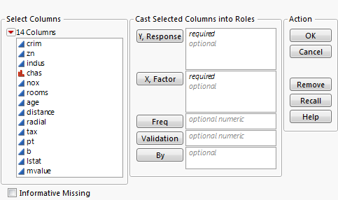

To launch the Neural platform, select Analyze > Predictive Modeling > Neural.
Figure 3.3 The Neural Launch Window
Validation
Choose a validation column. For more information, see Validation Method. If you click the Validation button with no columns selected in the Select Columns list, you can add a validation column to your data table. For more information about the Make Validation Column utility, see Make Validation Column Utility in the Predictive and Specialized Modeling book.
Informative Missing
For a continuous variable, missing values are replaced by the mean of the variable. Also, a missing value indicator, named <colname> Is Missing, is created and included in the model. If a variable is transformed using the Transform Covariates fitting option on the Model Launch control panel, missing values are replaced by the mean of the transformed variable.

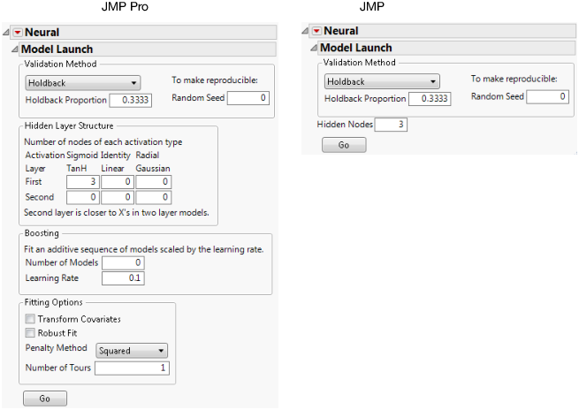

Figure 3.4 The Model Launch Control Panel
After you click Go to fit a model, you can reopen the Model Launch Control Panel and change the settings to fit another model.
