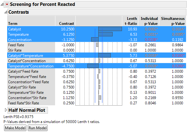

To change the number of default sets of simulations from 10,000, you must assign a value to a global JSL variable named LenthSimN. The number of simulations used to derive the p-values is reported in the report window.

Click the red triangle next to Screening for Percent Reacted and select Save Script > To Script Window.
6.
Insert LenthSimN=50000; as the first line of the script.
LenthSimN=50000;

Right-click in the script window and select Run Script.
