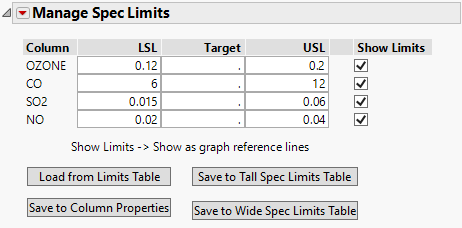

Select Analyze > Quality and Process > Manage Spec Limits.
Specify the columns you want to set specification limits on. For this example, select OZONE, CO, SO2, and NO, and click Process Variables.
Figure A.1 Specify Columns
Click OK.
5.
Add your specification limits. You can do this by loading existing limits from a JMP data table (Load from Limits Table) or by entering limits manually. For this example, enter the following limits manually:
OZONE: LSL 0.12, USL 0.2
CO: LSL 6, USL 12
SO2: LSL 0.015, USL 0.06
NO: LSL 0.02, USL 0.04
6.
From the red triangle next to Manage Spec Limits, select Show Limits All.
Specification limits for all columns will appear in graphs for any future analyses. If you want to show the specification limits only for individual columns, check the Show Limits box next to those columns.
Figure A.2 Set Specification Limits
7.
Choose how you want to save the specification limits. For this example, click Save to Column Properties. This saves them as column properties in the corresponding data table. You could also save them to a new data table (tall or wide format).
In the Cities.jmp data table Columns panel, notice that asterisks indicating the Spec Limits column property appear next to OZONE, CO, SO2, and NO.

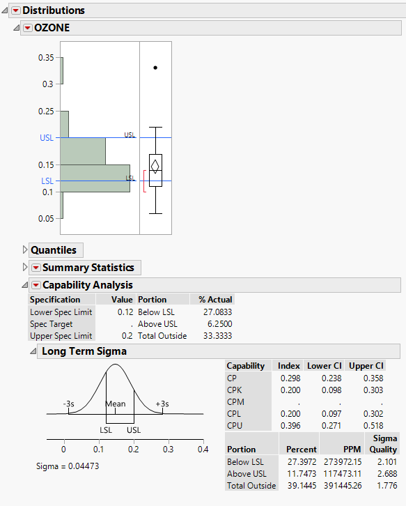

Now, you can run any analysis. For this example, select Analyze > Distribution.
10.
11.
Click OK.
The specification limits that you added to the OZONE column appear in the histogram. Because the column contains a Spec Limits column property, the Distribution report also contains a Capability Analysis report.
